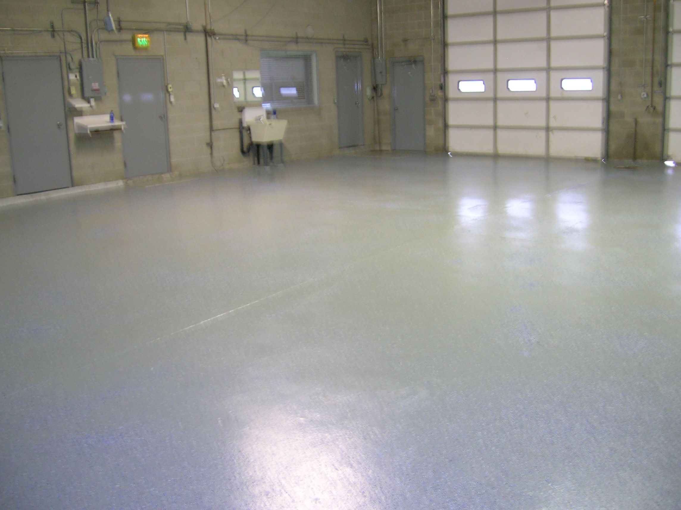

  • J. Larry Bloodworth
    Member
    December 10, 2020 at 5:00 pm
    My wife and I worked together to finish the shop floor with 2-part Floor Epoxy from Home Depot.  It ran us about $450 to do 3K sq. ft.  Here’s a link to what we used.  It took us 3 of these kits.
    https://www.homedepot.com/p/Rust-Oleum-EpoxyShield-2-Gal-Gray-Garage-Floor-Epoxy-261845/202963950
    In our experience, it lasts about 5 years then you have to touch up the areas that have chipped due to dropping stuff.  Before laying down the epoxy, we etched the floor with muriatic acid then neutralized and cleaned the floor with Tide laundry detergent.  We didn’t grind or sand the floor.  Hope this helps shop owners who have more time than money for a cool-looking shop floor.
    Here’s a fuzzy picture of what it looked like when we were finished:
    Semi-Gloss Epoxy Floor Coating
